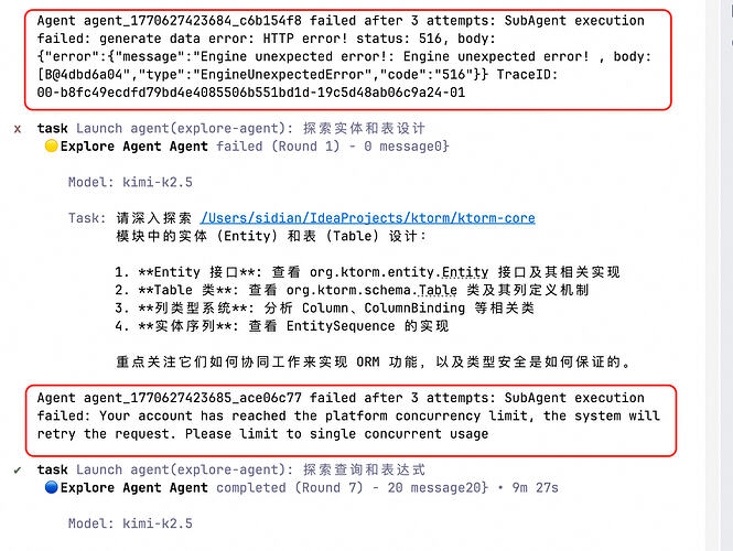

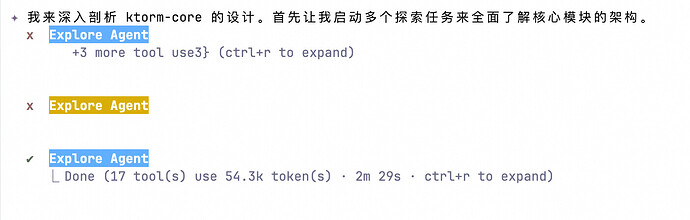

开了三个agent
挂了2个,报错如下:
 Agent agent_1770627423684_c6b154f8 failed after 3 attempts: SubAgent execution
 failed: generate data error: HTTP error! status: 516, body:
 {"error":{"message":"Engine unexpected error!: Engine unexpected error! , body:
 [B@4dbd6a04","type":"EngineUnexpectedError","code":"516"}} TraceID:
 00-b8fc49ecdfd79bd4e4085506b551bd1d-19c5d48ab06c9a24-01
 Agent agent_1770627423685_ace06c77 failed after 3 attempts: SubAgent execution
 failed: Your account has reached the platform concurrency limit, the system will
 retry the request. Please limit to single concurrent usage
模型:kimi-k2.5
@10008873411 大佬看看这个问题

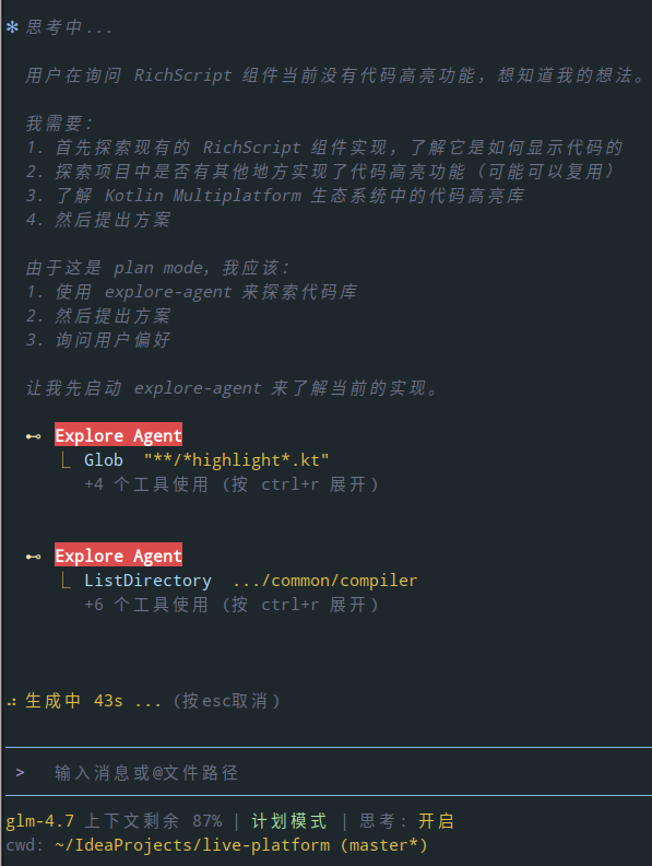

看起来,GLM4.7也会同时开多个agent,但不会遇到kmi k2.5的问题,如果都是一并发的话,这个怎么解释呢?
做了分时调度吗?还是失败重试?来保证多个agent不失败?
glm开3个并发的话 其实也不行了 :eyes: 实际上subagent支持2个
