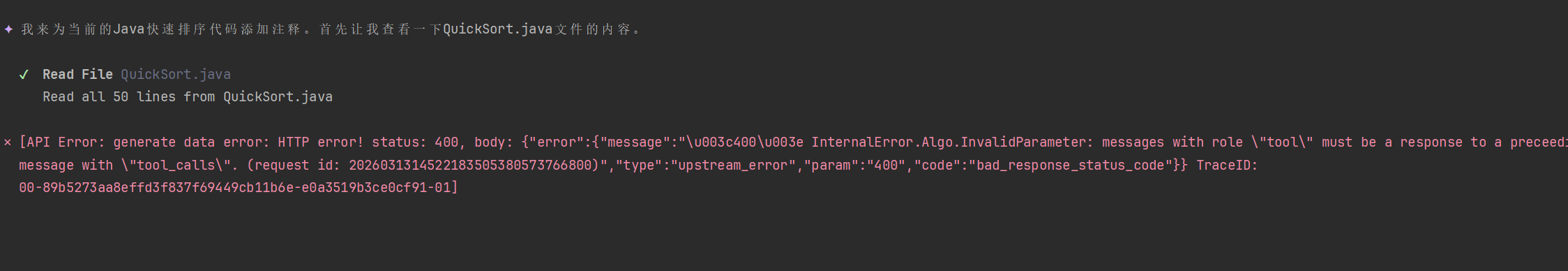

调用模型 tool call 报错InternalError.Algo.InvalidParameter
[API Error: generate data error: HTTP error! status: 400, body: {“error”:{“message”:“<400> InternalError.Algo.InvalidParameter: messages with role “tool” must be a response to a preceeding
message with “tool_calls”. (request id: 2026031314522183505380573766800)”,“type”:“upstream_error”,“param”:“400”,“code”:“bad_response_status_code”}} TraceID:
00-89b5273aa8effd3f837f69449cb11b6e-e0a3519b3ce0cf91-01]

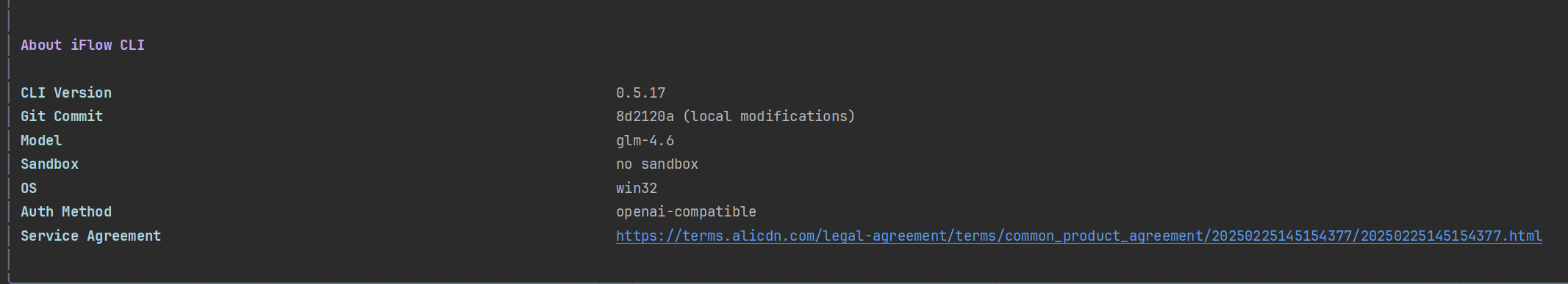

使用iflow的auth第三种方案,采用转发的阿里云的glm-4.6,执行就会报这个错。求解答
